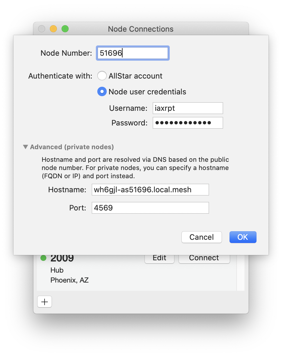

Advanced configuration
For registered nodes, Transceive resolves the IP address and port through DNS. For private nodes that are not registered in the AllStar directory, specify a host and port manually.
