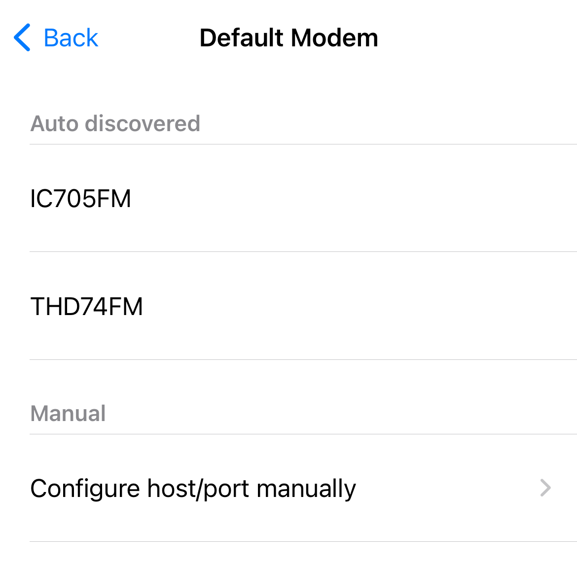

varanny uses DNS Service Discovery to broadcast the VARA modem services, making it easier for clients to locate an active VARA instance and automatically fetch its IP and port. This is similar to how your printer gets discovered on a network. Give your specific radio configuration a name and select it from the auto discovered list in RadioMail. No more fumbling with IP or port configuration in RadioMail.

  2. In RadioMail, tap Settings -> VARA FM Modem -> Default modem
  3. Under Manual, select Configure host/port manually
  4. Enter host and port information
  5. Tap Done

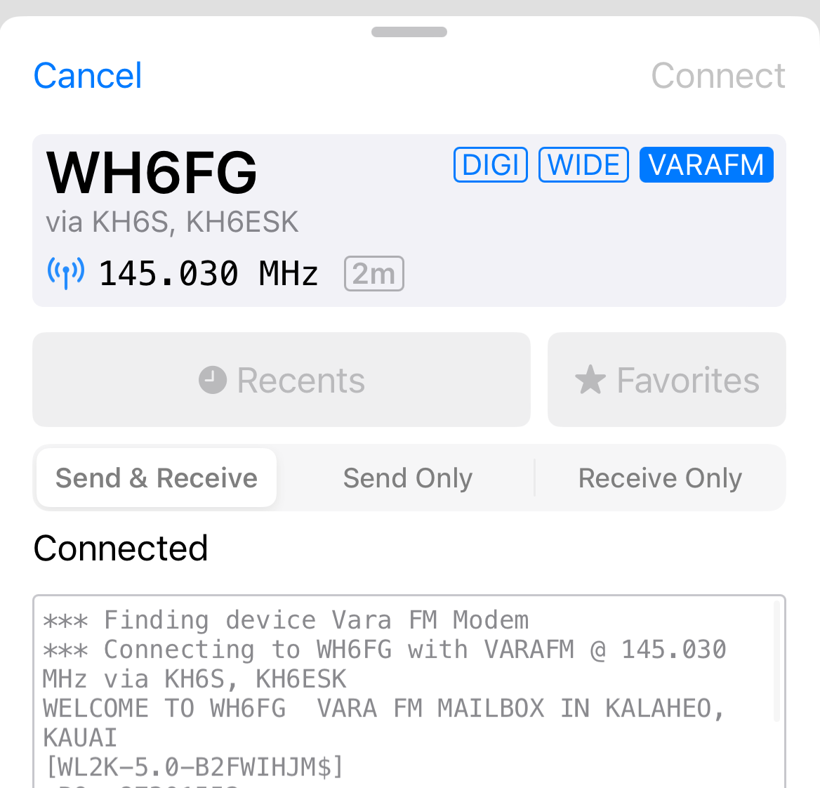

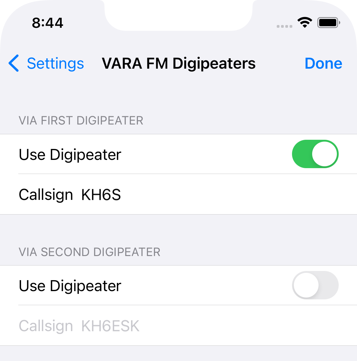

Digipeaters are special stations that receive and sequentially re-broadcast digital data on the same frequency, extending the range of communications. You can now specify up to two digipeaters to use when connecting to a station in packet or VARA FM mode.
For each mode, you can specify and quickly toggle on or off each digipeater in the Settings interface.
When digipeating is in use, the via path is displayed in the connection dialog, and the DIGI indicator is present.
Note that packet and VARA FM digipeaters are not interchangeable since they need specific knowledge of the protocol to listen to and retransmit the data.
