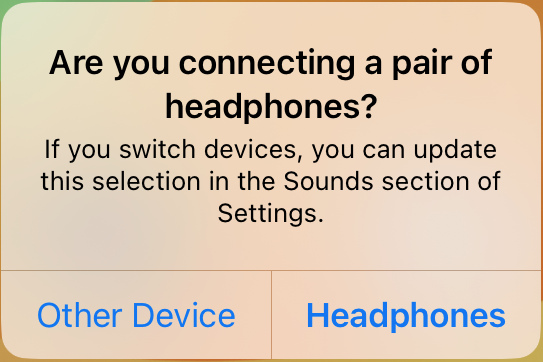

  1. Connect the DigiRig Lite or VOX to your device and turn on the radio.
  2. iOS may prompt you with "Are you connecting a pair of headphones?".
    Select "Other Device".

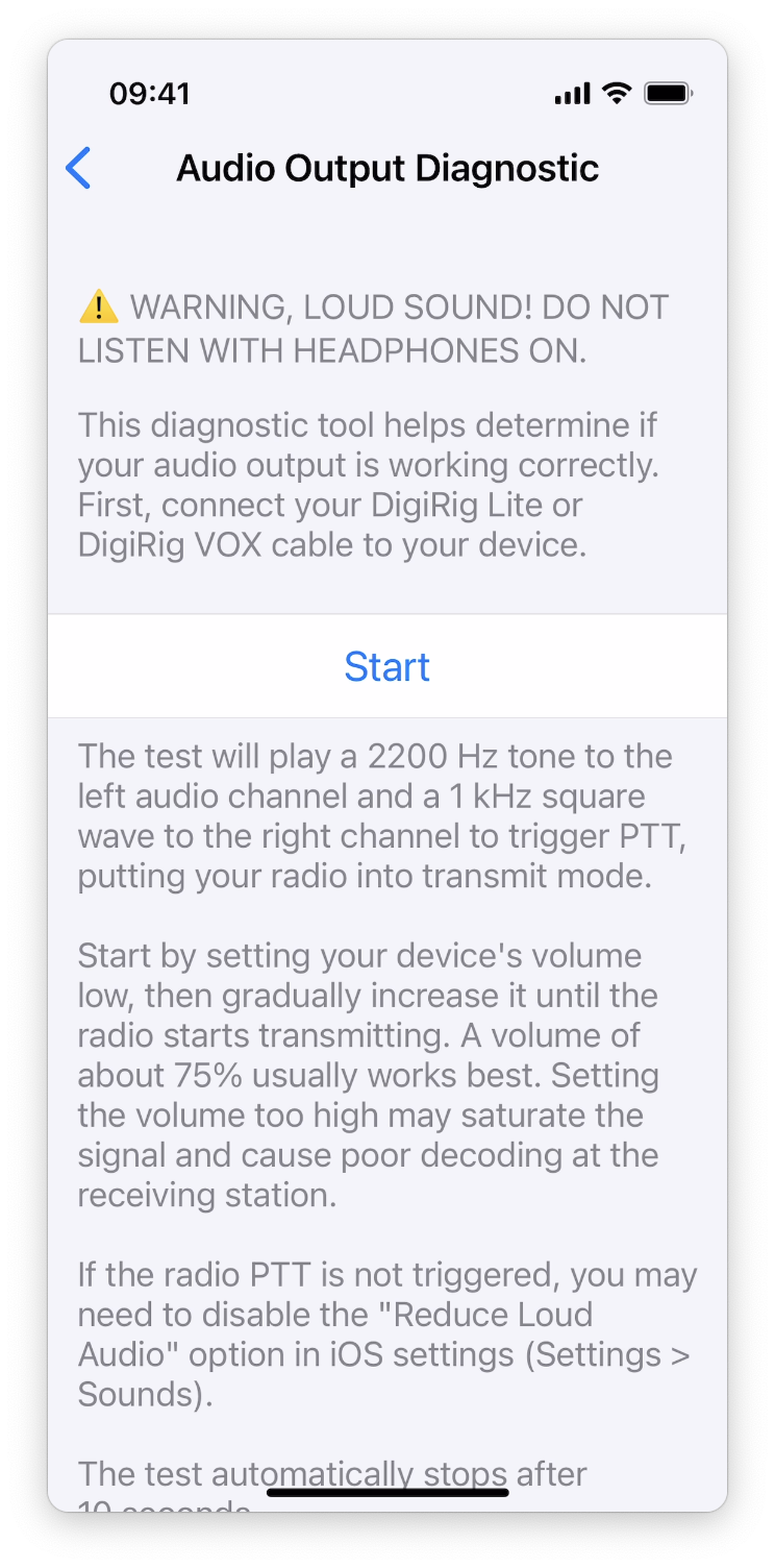

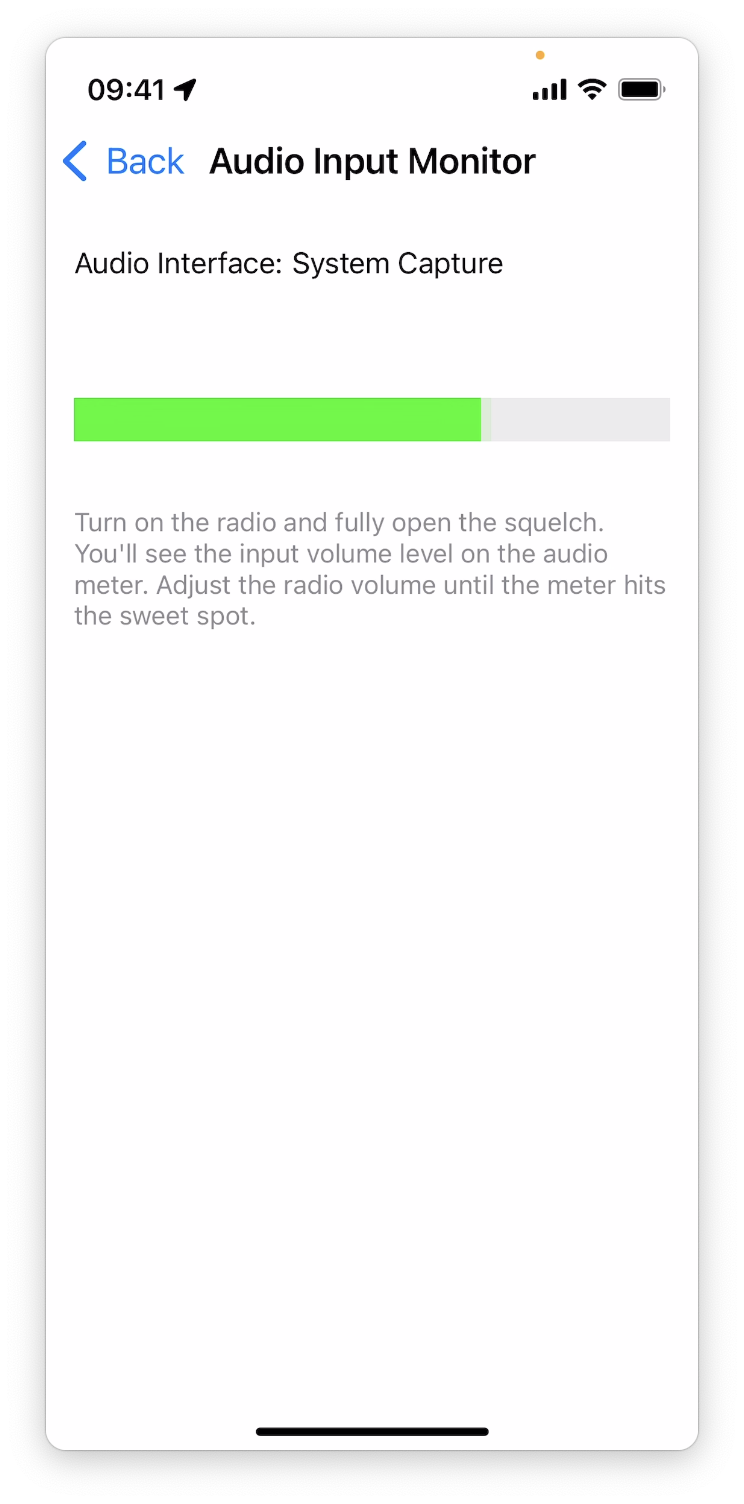

You can use the Audio Input Monitor and Audio Output Diagnostic function to ensure the device and radio volumes are setup properly.
Make sure that your phone notifications are turned off as any sound from the device will be sent to the radio.

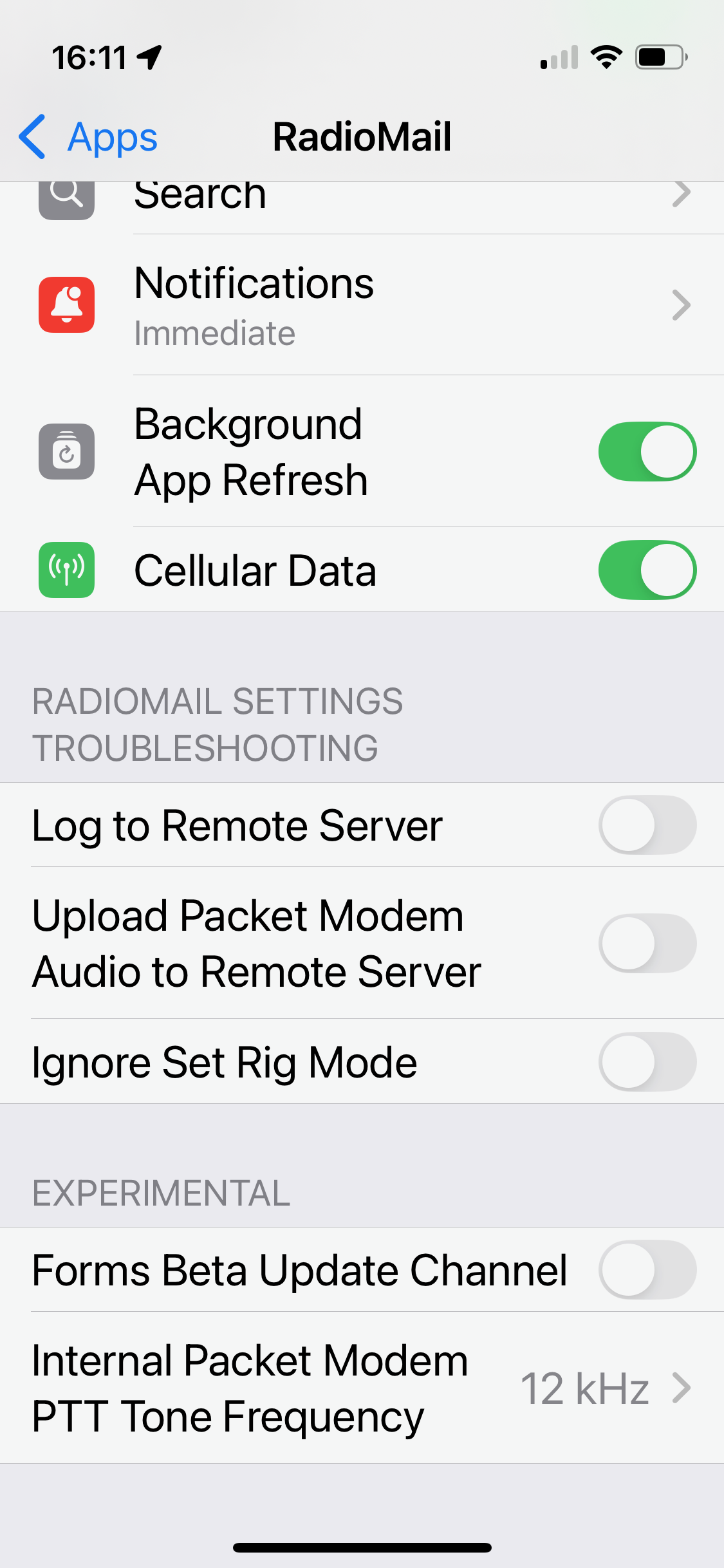

Adjusting PTT Tone Frequency
The default PTT tone frequency is 1kHz, but it can be adjusted. Some radios, like the Yaesu HT, use the same line for both mic audio and PTT. This can cause the PTT signal to bleed into the audio signal, especially when using the DigiRig VOX cable, which uses a passive circuit for PTT.
To avoid this issue, go to iOS Settings > Apps > RadioMail and set the PTT tone frequency to 12kHz so that it gets filtered out by the radio.

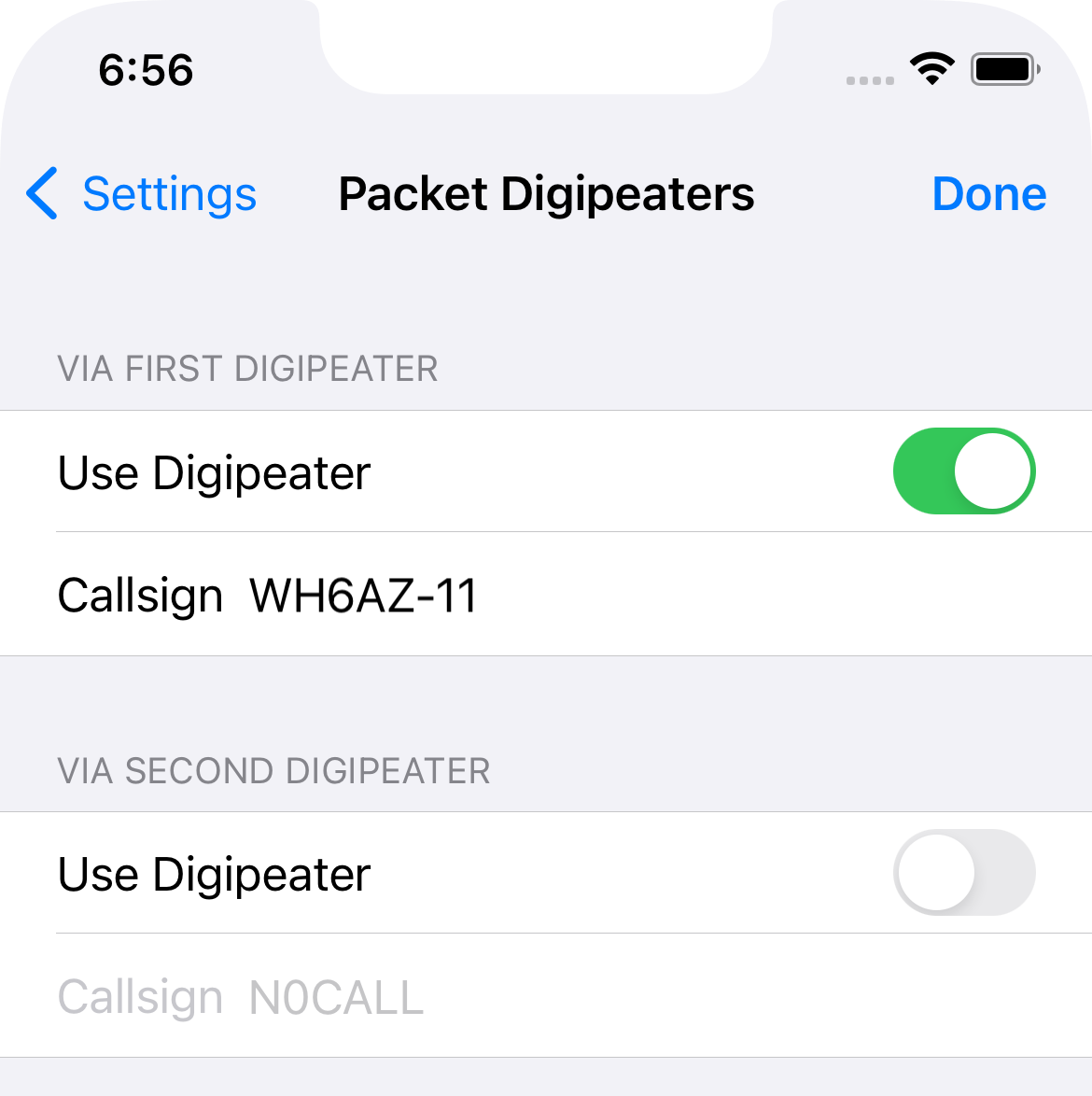

Configuring Digipeaters

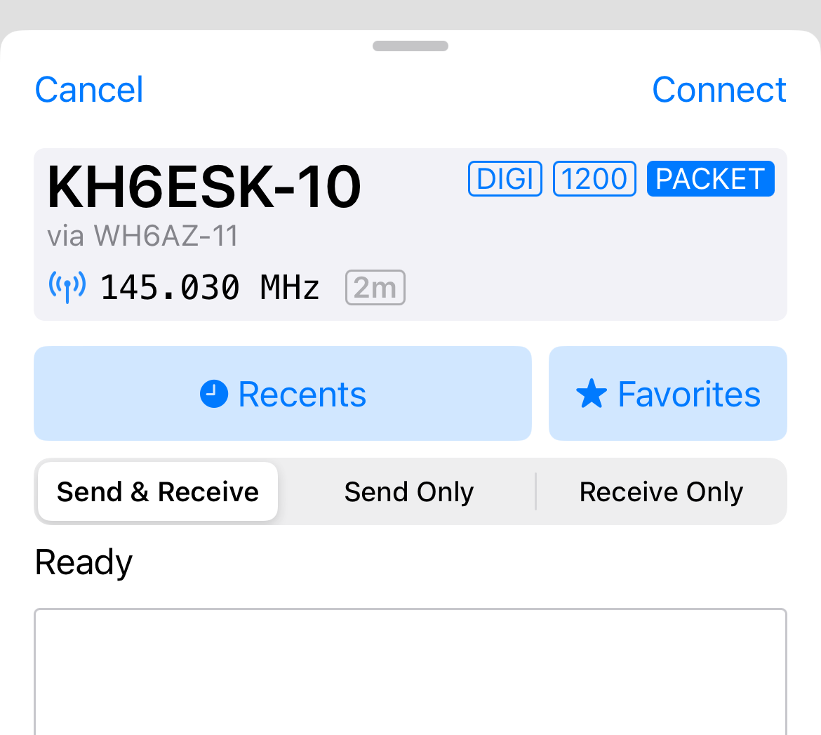

Digipeaters are special stations that receive and sequentially re-broadcast digital data on the same frequency, extending the range of communications. You can now specify up to two digipeaters to use when connecting to a station in packet or VARA FM mode.
For each mode, you can specify and quickly toggle on or off each digipeater in the Settings interface.
When digipeating is in use, the via path is displayed in the connection dialog, and the DIGI indicator is present.
Note that packet and VARA FM digipeaters are not interchangeable since they need specific knowledge of the protocol to listen to and retransmit the data.

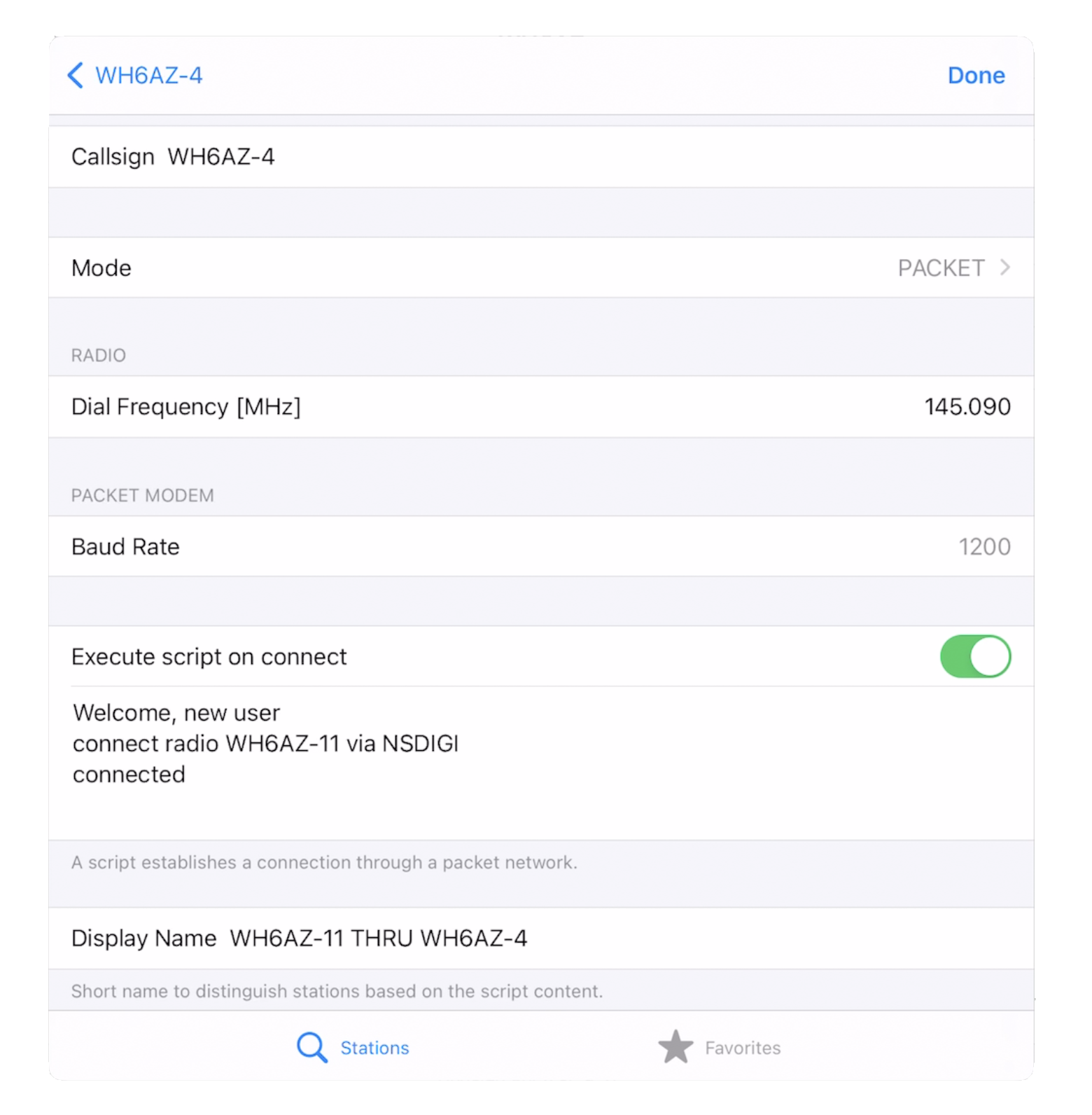

Configuring Connection Script
RadioMail can automatically run a script when connecting to a packet station. This can be useful to instruct a node to set up a connection path to another station.
To use a script, add a new station in the directory. The station callsign and frequency will be used to connect to the first node where the script is executed. Then toggle on script support and enter the script in the text field.
The script follows a very simple syntax. The connection command is prefixed with 'c', 'conn' or 'connect' followed by the port and station callsign. For example:
c radio WH6AZ-11
Any other line in the script is interpreted as needing to wait for a response. For example, to wait for a prompt before sending a command:
Welcome, new user
c radio WH6AZ-11
Scripts commands and responses evaluation are case insensitive. By default, RadioMail will timeout after 60 seconds if no response is received following a connection request.
Packet stations with script can have a custom name that will be displayed instead of the station callsign. This is useful to distinguish between multiple station entries with the same callsign but different scripts.
