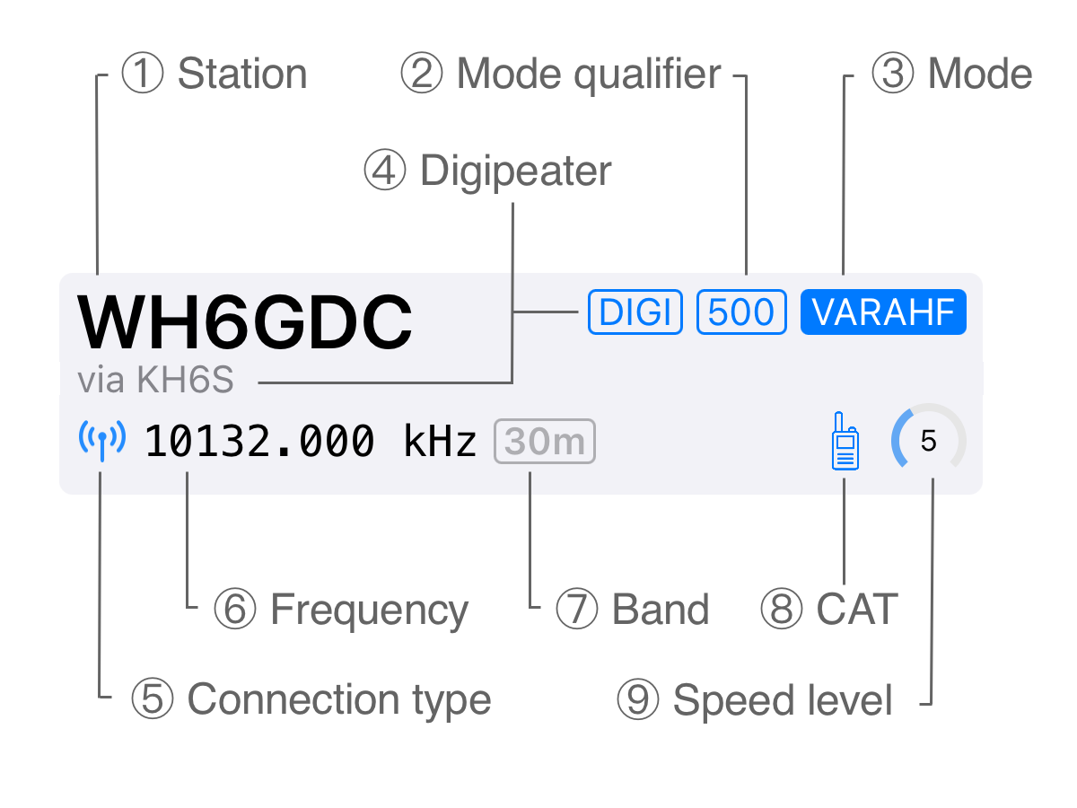

The connection display shows various information related to the selected station and the mode of connection.
① Station
Callsign of the remote station
② Mode Qualifier
Packet: baud rate, 1200 or 9600.
VARA FM: NARROW or WIDE.
VARA HF: bandwidth of 500, 2300 or 2750 Hz.
③ Mode
Digital mode used for the connection, TELNET, PACKET, VARAFM or VARAHF.
④ Digipeater
Present when a digipeater is configured.
⑤ Connection type
Radio or TCP/IP
⑥ Frequency
Dial frequency for the station
⑦ Band
Band
⑧ CAT
Present when RadioMail will control the frequency of the radio.
⑨ Speed level
VARA speed indicator. Each level correspond to a maximum throughput as described in the VARA FM Speed Levels and VARA HF Speed Levels tables.
